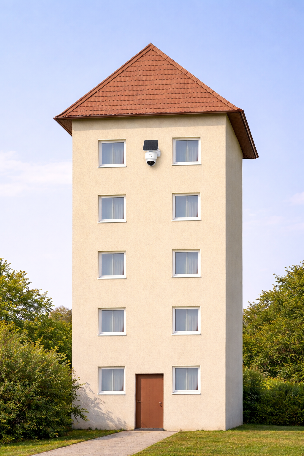

Here’s an illustration comparing mounting heights with security camera POV

Mounting too high
Some homeowners mount cameras near the roof peak (15–20 feet). This often results in footage that doesn’t capture identifying details and negates the effectiveness of motion detection.
