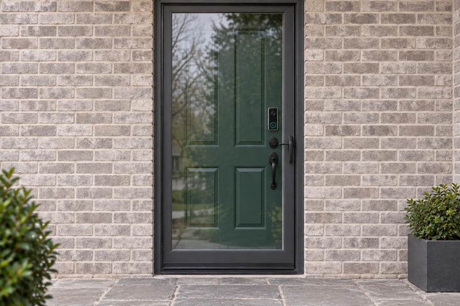

Video Doorbells
Recommended height: 4-5 feet
Video doorbells are meant to be installed at an easy-to-reach height so guests can ring the chime. This also allows for an extremely clear front view of visitors and strong package monitoring.

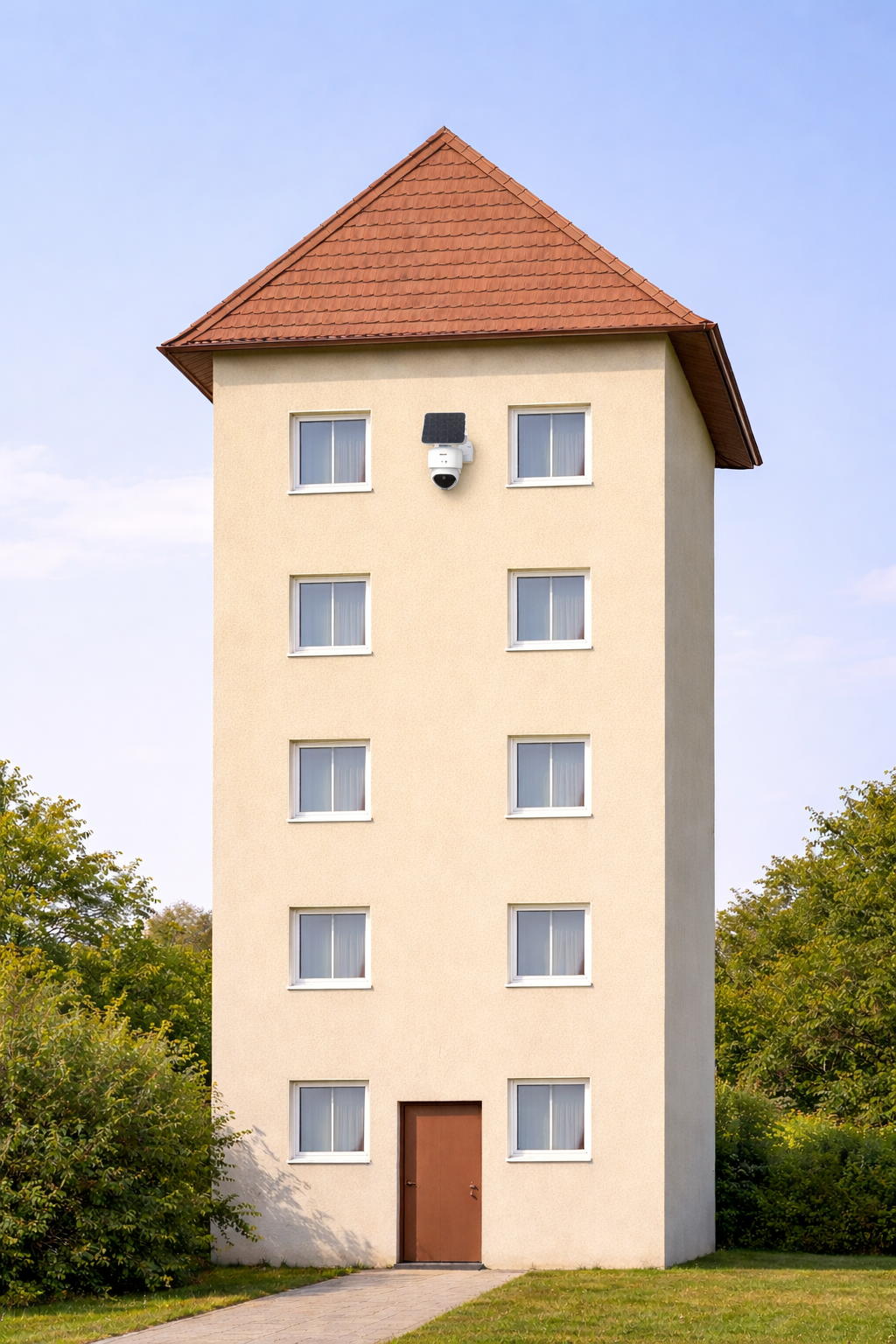

Mounting too high
Some homeowners mount cameras near the roof peak (15–20 feet). This often results in footage that doesn’t capture identifying details and negates the effectiveness of motion detection.
