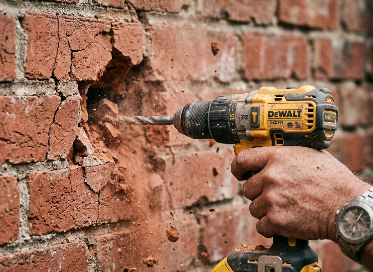

Step 3 — Drill Into the Brick
Use a masonry drill bit and drill slowly into the brick at your marked points.
Key tips:
- Drill into the brick, not the mortar
- Keep a steady pressure while drilling
- Drill to the depth of your wall anchors
Why avoid mortar?
Mortar is softer and easier to drill, but it’s also crumblier and mounts are more likely to loosen over time.
Drilling into brick gives you a much more secure installation.
