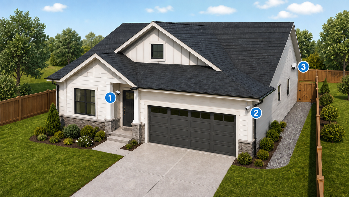

Three security cameras numbered around the front, garage, and side yard of a detached home
Work out how many security cameras your home needs by mapping entrances, activity routes, blind corners, and the level of detail each area requires.
There is no universal number of security cameras that every home needs. A small home with several hidden approaches may need more views than a larger home with one clear entrance.
The practical way to calculate your camera count is to map what must stay visible, where activity can come from, and how much detail you want. This planner turns those questions into a camera-by-camera plan before you buy or drill any holes.
The Short Answer
Count coverage zones, not rooms. A coverage zone is an area that needs its own reliable view, such as a front entrance, driveway, backyard door, or important shed.
One well-placed camera may cover more than one nearby feature. Two areas usually need separate cameras when they cannot fit in the same clear view, must remain visible at the same time, or require different angles for useful detail.

    Sketch the home, street, driveway, doors, gates, paths, stairs, fences, and detached structures. Add arrows showing how a person or vehicle would move through the property. These routes usually reveal the most valuable camera positions.

    A front walkway and nearby porch may fit one camera. A driveway and side gate around a corner probably will not. Keep zones separate when both need continuous coverage or one would sit near the weak edge of the frame.

sample of a home security camera plan with priority labels
Prioritize entrances and constrained routes. Large open areas can remain optional unless they relate to a specific concern.

example of when one camera can cover two areas vs when two separate cameras are needed
Property shape determines whether nearby areas can share one view or need separate cameras.

Compact home with front and rear entrances C1: front approach and porch; C2: rear-door approach The house blocks the view between the two entrances
Detached home with driveway and concealed side access C1: front entrance; C2: driveway; C3: side gate; C4: rear entrance Each position serves a separate priority route or detail requirement
The first example starts with two positions; the second starts with four. Neither is a recommendation based on floor area.

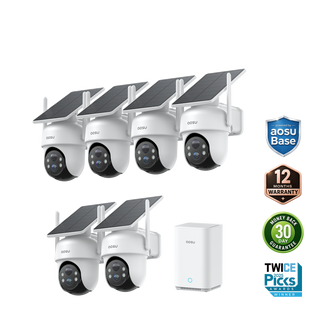

SolarCam T2 Ultra System — aosuBase 2.0 Version
The official hub comparison lists 32GB of built-in storage and expansion up to a 1TB SD card for aosuBase 2.0.
The aosuCortex version is a different configuration, with a listed hard-drive expansion limit of 16TB.
Choose the camera positions first, then confirm the selected kit’s camera quantity, compatible devices, included storage and expansion requirements. An expansion limit does not mean that storage capacity is included.
Save 20%
32GB internal local Storage, up to 1TB丨4K TrueColor Night Vision丨360° PTZ, Cross Camera Event Tracking丨Triple Detection, Smarter Alerts丨Solar + 9200mAh Battery Powered

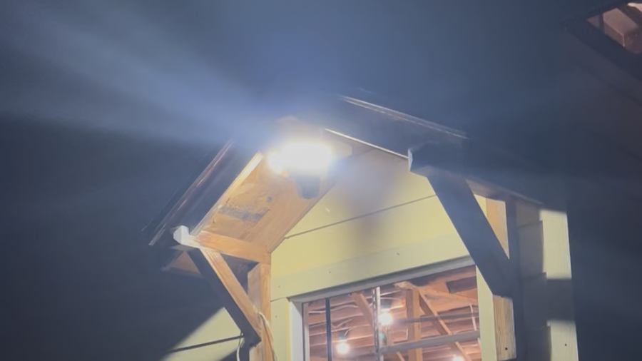

  4. Night changes the scene
    Glare, deep shadows, reflective walls, limited infrared range, and fast movement can weaken a view that looks excellent during the day. Always review actual nighttime footage.
