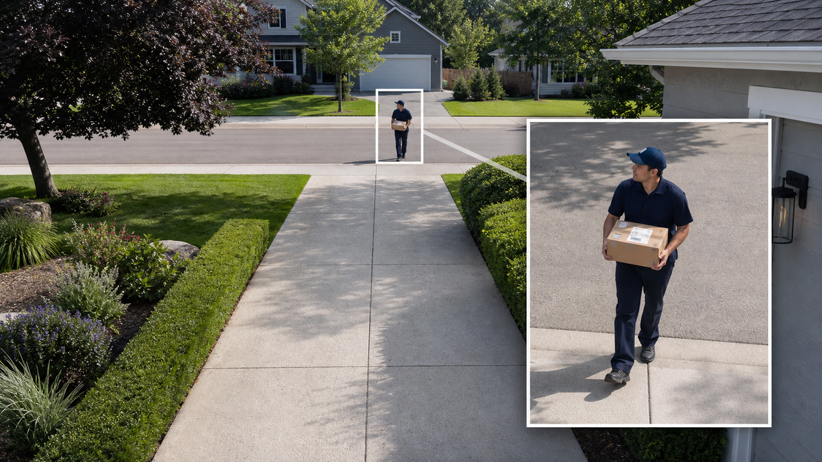

The clearest 4K benefit is crop room. You can enlarge one part of a recording while retaining more source information than the same framing would capture at 2K. This helps when a person stays far from the camera or when one fixed view covers the garage, vehicles, walkway, and street approach together.
The example below comes from the 4K version of the aosu SolarCam Kit D1 Max. The person holding the dartboard is approximately 30 feet (9 meters) from the camera. The enlargement does not become a close-up photograph, but it reveals why extra source pixels can help during post-event review.
This is a real 4K full-frame-and-crop example, not a controlled comparison against an identical 2K recording. It demonstrates what crop room looks like; it does not prove that resolution was the only factor shaping the image.
real aosu solarcam D1 max 4k footage and zoom
Real 4K D1 Max footage: full frame above and an enlarged detail from the same recording below.
