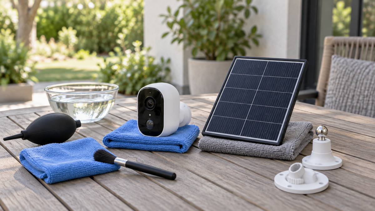

Choose a cool, dry time when the panel is not hot from direct sun. Work from the ground or a stable platform whenever possible. If a ladder is necessary, inspect it, keep three points of contact while climbing and do not carry cleaning supplies in your hands.
1. Gather gentle cleaning tools: Use a clean bulb blower or very soft brush for loose dust, clean microfiber cloths, clean water, and a soft non-abrasive sponge for the panel. Use water, lens-cleaning fluid or mild detergent only when the instructions for the surface being cleaned allow it, and apply liquid to the cloth or sponge rather than spraying the device.
2. Keep damaging tools away: Do not use abrasive pads, dry scraping, household solvents, metal tools, a pressure washer or canned compressed air. Paper towels can trap grit and are a poor choice for coated optical surfaces.
