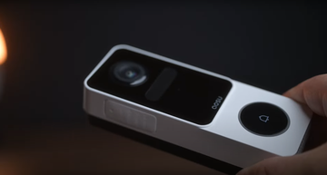

To help you upgrade with confidence, aosu offers three smart video doorbells, each designed for different homes and budgets:
Video Doorbell Ultra
Best for families who want maximum visibility and security. Great if you receive packages often or want a full view of your front door area.
aosu Video Doorbell Pro
What’s good:
  1. Dual-camera design lets you see people and packages at the same time
  2. Covers blind spots with wide and downward angles
  3. Smart motion detection filters out false alarms
The Video Doorbell Pro is ideal for homes with tricky lighting or lots of foot traffic. Designed to handle real-world conditions like bright sun and deep shade.
