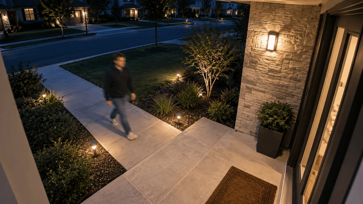

If a person looks smeared or ghosted while the background stays sharp, your camera is probably focused correctly. The more likely problem is motion blur.
At night, a security camera may keep its shutter open longer to collect more light. That brightens the scene, but it also gives a moving person more time to travel across the image. Better lighting, a more useful camera angle, or a shorter exposure—when the camera provides that control—can produce clearer footage.
Why Do People Look Blurry When Moving at Night?
People blur because they change position while the camera is collecting one frame. The wall, path, or yard does not move, so it can remain sharp. That pattern usually points to subject motion blur rather than a focus problem.
Start by matching what you see to the most likely cause before changing several settings at once.

Shutter speed is the amount of time the sensor gathers light for one frame. In dim conditions, automatic night mode may lengthen that exposure to make the scene brighter.
This is the basic cause of night vision camera motion blur: a person moves across multiple pixels before the exposure ends. The camera must balance brightness, noise, and motion detail, so a brighter night image is not always a sharper one.

Can a Porch Light Improve Security Camera Footage?
Yes. More even light can help the camera use a shorter exposure, which can reduce motion blur. Aim porch lighting across the approach path instead of creating one bright patch beside the door or shining directly into the lens.
Visible light can help a camera preserve color. Infrared illumination can improve a black-and-white night view without lighting the area for people, but nearby walls, soffits, glass, signs, or even protective film can reflect infrared back into the lens.
What looks like infrared security camera ghosting is often a combination of longer exposure, strong noise reduction, or reflected infrared light. If faces wash out only at close range, test for reflections before treating the problem as poor focus.
