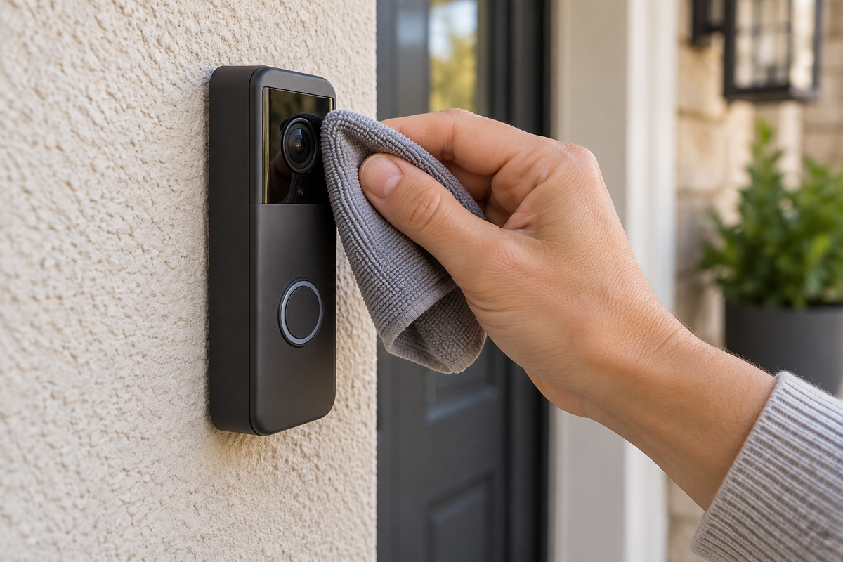

1.  Remove loose dust before wiping: Hold the bulb blower a short distance from the lens window and send a few gentle bursts across the surface. Work around the rim as well. This removes particles that could scratch the cover if they were trapped under the cloth.
2.  Make a light pass with a dry microfiber cloth: Fold the cloth so a clean section covers your fingertip. Wipe with light, overlapping strokes and lift the cloth away as soon as the loose film is gone. Do not press the lens window inward or polish one spot repeatedly.
3.  Use minimal moisture on stuck marks: Dampen one corner of the cloth with clean water, then squeeze or blot it until it is only slightly damp. Wipe the spot gently. Keep the damp section away from the microphone, speaker, button edge, charging cover, and housing seams.
4.  Treat oily residue only if it remains: Check the model's care instructions before using any liquid beyond water. If they allow an optical cleaner, place a small amount on the microfiber cloth rather than spraying the doorbell. Clean the mark once, then switch to a dry section.
5.  Dry the lens window and surrounding edges: Use the second microfiber cloth to remove remaining moisture and streaks. Look across the surface from an angle; a thin smear that is hard to see head-on can still scatter porch lights or infrared illumination at night.
6.  Compare the live view: Reopen the same view and compare it with your earlier screenshot. Check a saved clip as well as live video. If nighttime haze was the problem, repeat the check after dark before changing image settings or repositioning the doorbell.
