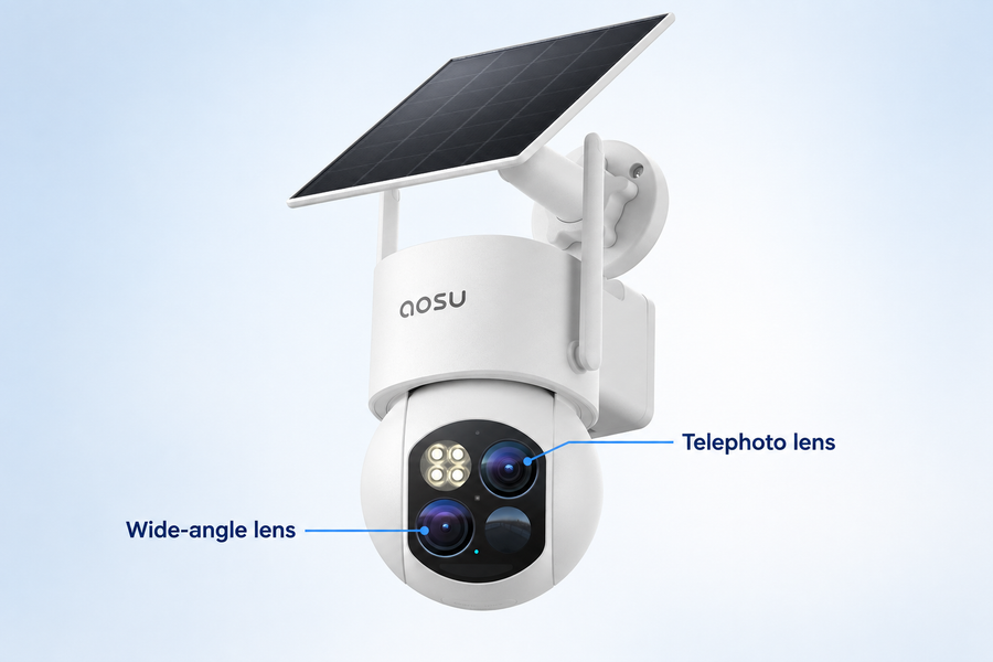

1:23 – T2 Ultra and T2 Pro as two different camera approaches T2 Ultra and T2 Pro as two different camera approaches
Compares 4K PTZ coverage with the T2 Pro's wide view plus PTZ tracking.

For a driveway or garage, a T2 Ultra can work well when you want a PTZ camera to follow movement through one main approach area. For front-yard, backyard, or side-yard coverage, T2 Pro can be useful when you want a wide overview and a moving PTZ view at the same time.
Before drilling, hold the camera near the planned location and check the live view in the app. Look for blind spots, glare, tree branches, rooflines, and areas where passing cars or sidewalk traffic could create unnecessary alerts.
Compare aosu T2 Pro vs T2 Ultra
