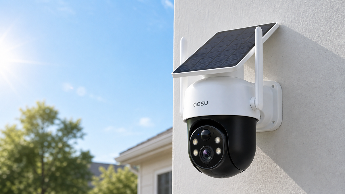

A solar security camera usually has three basic parts: the camera, a rechargeable battery, and a solar panel. The panel collects sunlight during the day, the battery stores that energy, and the camera uses the battery to record, send alerts, run night vision, and stay connected.
Some cameras have the solar panel built into the camera body. Others use a separate panel connected by a cable. Separate panels can be useful because the best camera view and the best sun angle are not always the same place.
That is the main concept to remember: solar helps replace used battery power, but the camera still has to manage that power carefully.

Built-In Solar Panel vs Separate Solar Panel
A built-in solar panel can look cleaner because there is less hardware to mount. It can work well when the camera naturally faces a sunny direction.
A separate solar panel is often more flexible. You can aim the camera at the area you want to monitor while placing the panel nearby where it gets better sunlight. This is especially useful near eaves, corners, trees, and shaded entry points.
Neither design is automatically better. The better choice depends on whether your camera view and your sun exposure line up.
