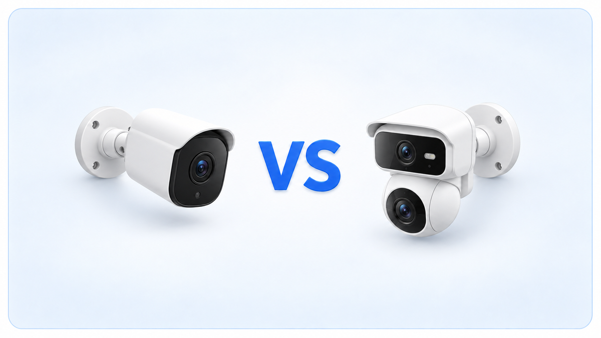

Choose a single-lens security camera when one well-framed view covers the area you care about. Choose a dual-lens camera when the same mounting point needs to keep a wider scene visible while also showing closer detail or a second direction.
The second lens does not automatically make a camera sharper or better. The useful difference comes from what the two lenses capture, whether both views remain available together, and how well that layout fits your driveway, yard, gate, or porch.
This comparison separates single fixed cameras, single-lens PTZ cameras, and the main dual-lens designs so you can judge coverage, detail, and tradeoffs without relying on the lens count alone.
Dual-Lens vs. Single-Lens Security Cameras at a Glance
A single fixed camera is the simplest choice for one stable area. A single-lens PTZ camera can move to inspect different directions, but it still shows one camera view at a time. A dual-lens camera can keep two native views available when its hardware and app support simultaneous viewing or recording.
