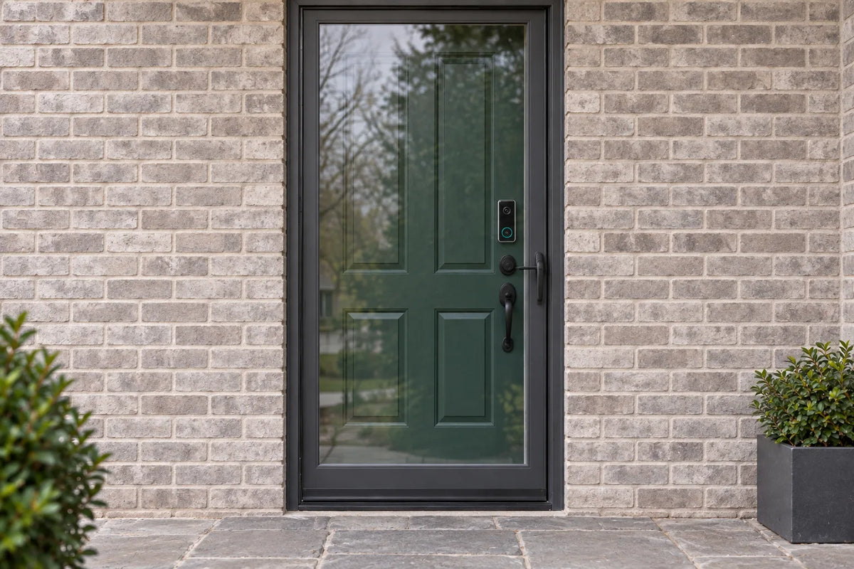

Yes, a video doorbell can often work behind a storm door or screen door, but an outside-facing mount is usually a better starting point. The outer door can affect fit, camera clarity, Wi-Fi strength, motion detection, and two-way talk. Before mounting anything permanently, close both doors, test a live view and a visitor call, and check the image in daytime and after dark.
Can the Outer Door Close Fully With the Video Doorbell in Place?
Start with clearance. A video doorbell that protrudes even slightly may keep a storm door from latching, scrape the device, or place constant pressure on its button. Do not judge fit with the storm door open.
Hold the doorbell, its bracket, and any wedge where you plan to install them. Then slowly close the outer door from fully open to fully latched. Check the closest points: the storm-door frame, latch-side rail, handle, closer hardware, and decorative glass insert. Allow room for normal seasonal expansion and for a door that may sag a little over time.
If the door closes but rubs the doorbell, move the device rather than accepting contact. Repeated contact can change the camera angle, block the button, or damage the housing. A battery-powered video doorbell can make repositioning easier because its installation does not need a new low-voltage wire run, but it still needs a stable Wi-Fi connection and a protected mounting surface.
| What you find | What it usually means | Safer next move |
| Door will not latch | The device or mount is in the swing path | Move it away from the frame or mount outside |
| Door latches but touches the device | Clearance is too tight for regular use | Reposition before fastening |
| Door clears but button is hard to reach | The outer frame or lock blocks the visitor side | Change height or side position |
| Door clears in warm weather but rubs in cold weather | Alignment or expansion is marginal | Leave extra clearance and retest in the season |
How Glass, Screens, and Frames Change the Camera View
A storm or screen door can affect what a video doorbell captures. Test the view with the outer door both open and closed before finalizing the mounting position.
Glass Can Create Reflections and Glare
Glass is most likely to affect the view at night. Porch lights and indoor lighting can reflect into the lens, making the visitor or package area harder to see.
Screens Can Reduce Fine Detail
A screen can soften fine details, make raindrops more noticeable, or create wavy lines in the live view. Check the image with the screen door open and closed before deciding on the final position.
Frames Can Block Part of the Entryway
A thick frame, kick plate, or decorative grille can hide part of the approach path or the package drop zone. Test the view from your usual phone: walk from the sidewalk to the button, stand close to the door, and place a package at the normal drop spot.
If glass glare or the frame limits the view, try a slight side angle. Make sure the lens is clear of bright lights, metal trim, and any torn or loose screen material.
Will Motion Alerts and Two-Way Talk Still Work With the Outer Door Closed?
Yes, motion alerts and two-way talk can still work with the outer door closed. Test each function separately, because a closed door may affect the doorbell security camera’s view, button access, Wi-Fi signal, microphone, or speaker differently.
Use this short test while the outer door is closed:
- Have someone approach from the walkway and wait at the door.
- Confirm whether a motion alert arrives and whether the live view shows the person promptly.
- Ask the visitor to press the button once and listen for the outdoor and indoor chime response.
- Start two-way talk. Each person should speak one short sentence at a time.
- Repeat with the outer door open, then compare the results.
If the alert or talk only fails when the outer door is shut, the door material or placement is part of the problem. The final result in a particular entryway still depends on the door construction, router location, and mounting position.

Choose a Mounting Position That Keeps Both Doors Moving Freely
Choose a fixed surface on the visitor side of the outer door whenever possible. Keep the video doorbell outside the swing path of both doors.
Before drilling, use painter’s tape and a paper template to test the proposed location:
- Open and close both doors several times with the template in place.
- Check that the mount stays clear of the latch, handle, closer, and frame.
- Confirm that a visitor can reach the button when the storm door is locked.
- Install any wedge during this test, since it adds depth to the setup.
Once the position passes these clearance checks, repeat the closed-door camera-view, motion-alert, and two-way-talk tests before making the installation permanent.
When Is an Outside Mount More Practical Than a Behind-a-Door Setup?
An outside mount keeps the lens and button clear of the outer door, so it is usually the better starting point. A behind-the-door position can still work if it passes the fit and performance checks above.
An outside position is usually more practical if:
- The outer door cannot close freely, or the lock and frame block access to the button.
- Glass, screens, or trim still limit the camera view after you adjust the angle.
- The closed door weakens Wi-Fi, motion alerts, or two-way audio.
Before moving the doorbell outside, confirm that the new location has a secure mounting surface, usable Wi-Fi, and protection consistent with the model’s installation instructions.
Make Visitor Checks Work Reliably Through Every Season
Weather, new hardware, and seasonal door movement can change how a video doorbell performs. After a storm, screen replacement, or router change, check that both doors close freely, the button remains accessible, and the camera view and two-way talk still work with the outer door closed. Before your next busy delivery season, run this quick test and adjust the mounting position if needed.
