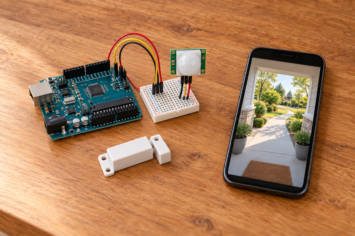

What an Arduino Home Security System Actually Includes
The board is one component, not the full system. A typical build needs sensors, outputs, power, code, an enclosure, and a way to communicate. Video, remote access, and event history add more hardware and software.
A Wi-Fi-capable Arduino can connect sensors to a dashboard, triggers, or notifications. You still decide how events are authenticated, stored, delivered, updated, and recovered after a failure.
  1. Sensors: Door contacts, PIR motion sensors, vibration sensors, buttons, and other inputs detect a change. You select, wire, position, and test each one.
  2. Controller and response: The board follows the rules in your sketch and can activate a buzzer, light, display, relay, or another low-voltage device. You define timing, arming behavior, and restart behavior.
  3. Network and access: Wi-Fi can connect the project to a dashboard or notification service. You manage credentials, permissions, connection failures, and any internet-facing service.
  4. Recording and history: A useful history needs timestamps, storage, overwrite rules, and a way to find an event. Video also needs a camera, encoding, bandwidth, more storage, and a viewing interface.
  5. Maintenance: Firmware, libraries, certificates, passwords, batteries, storage media, and your own code all need attention over time.
