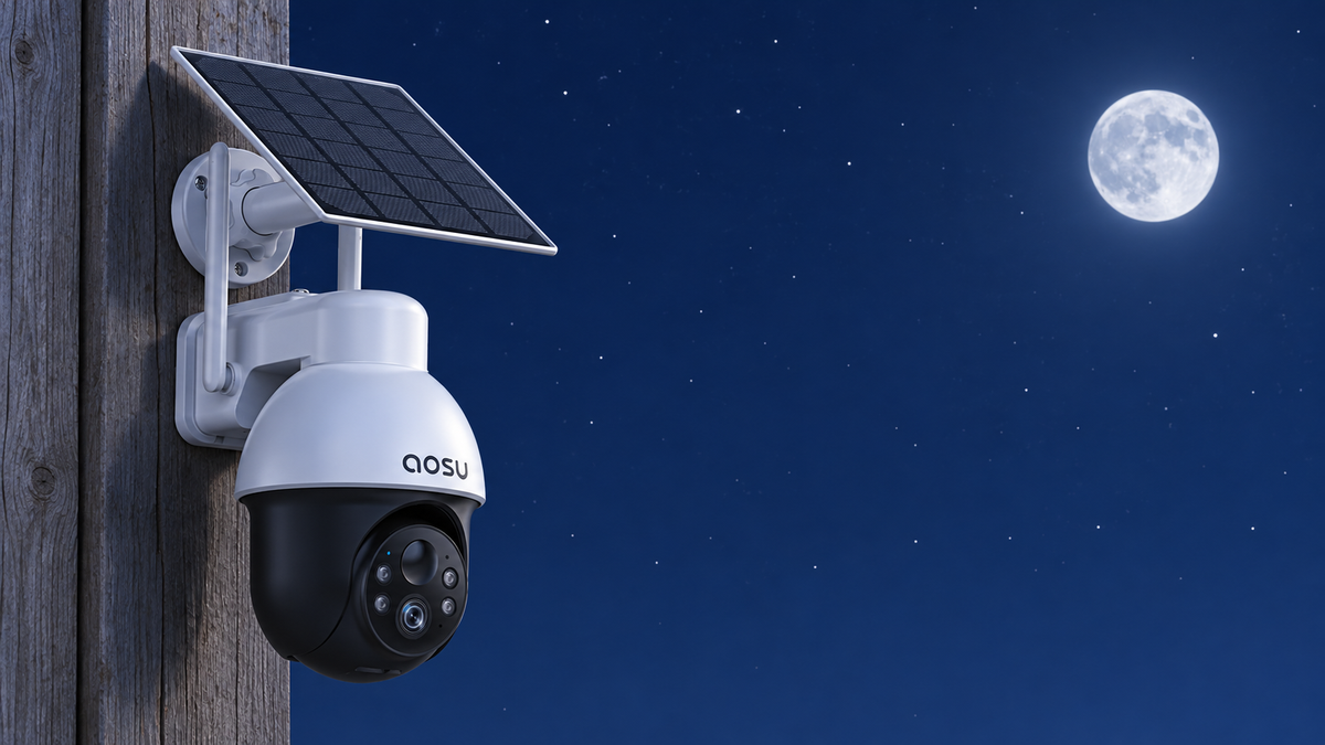

Yes. Solar security cameras work at night by using energy stored in a rechargeable battery. The panel charges the battery during daylight; after sunset, the battery powers motion detection, recording, night vision, alerts, and live viewing.
The more useful question is whether your panel, battery, night mode, and overnight activity can keep the camera working until morning.
How Daytime Charging Becomes Nighttime Coverage
A solar security camera is a battery camera with a solar charging source. Daylight puts energy into the battery. Recordings, wireless communication, night-vision lights, spotlights, alerts, and live viewing use it.
A quiet side gate may trigger only a few clips overnight, allowing the panel to replace that energy the next day. A camera facing a busy street may record people, cars, animals, and moving branches throughout the night. The same panel and battery can struggle at the busier location because the camera spends more energy before sunrise.
