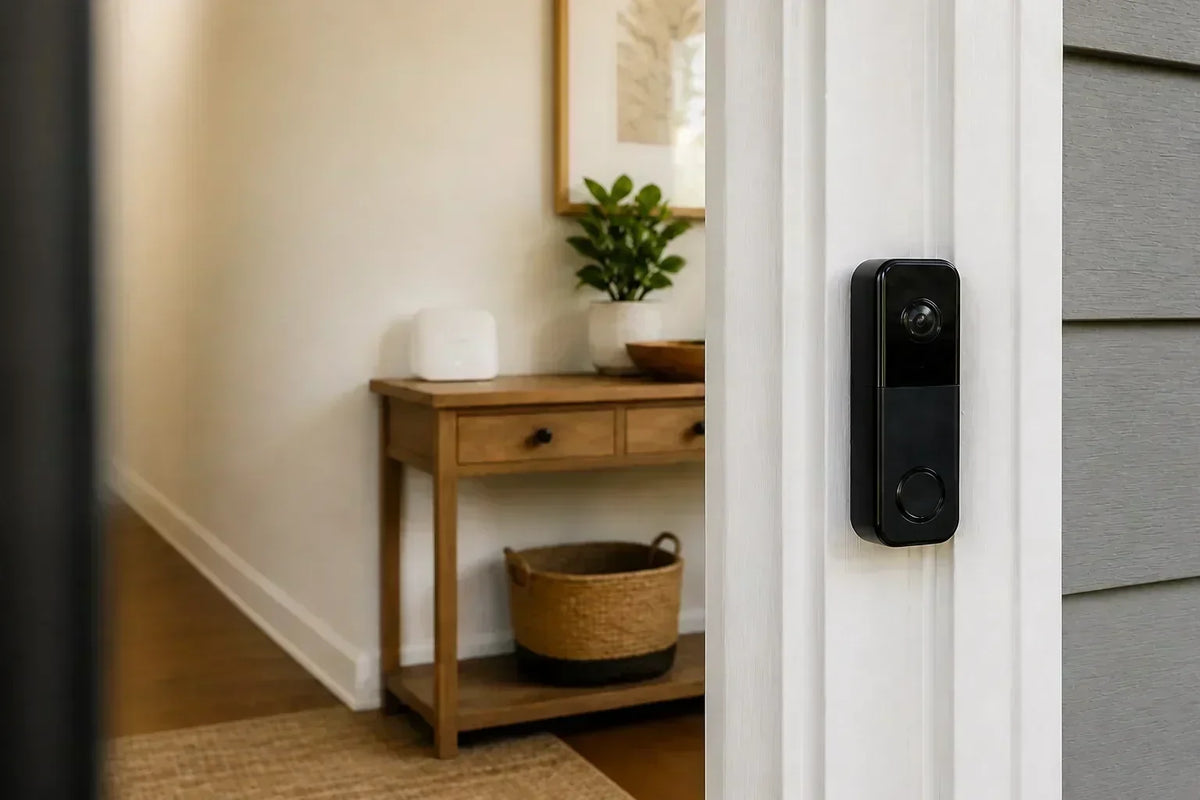

Black video doorbell mounted outside an entryway, with a separate white storage hub visible inside the home.

  • Built-in doorbell memory: The footage remains inside the outdoor device.
  • A microSD card in the doorbell: The footage is written to a removable card installed in the outdoor unit.
  • An indoor hub or base station: Recordings are stored on a separate device inside the home. The hub may have built-in memory or use its own microSD card.

An indoor hub keeps supported recordings on a separate device inside the home. If the doorbell is removed or damaged after the clip reaches the hub, the stored recording may remain available.
However, the recording path matters. Some systems write footage to the hub first, while others may initially capture it on the doorbell and transfer it afterward. If the device loses power or its connection before that transfer finishes, the complete clip may not reach the hub.
