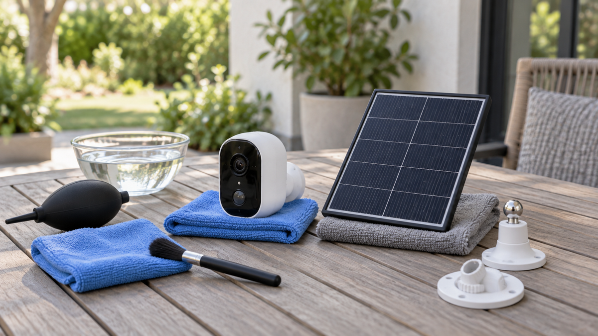

1. Gather gentle cleaning tools: Use a clean bulb blower or very soft brush for loose dust, clean microfiber cloths, clean water, and a soft non-abrasive sponge for the panel. Use lens-cleaning fluid or mild detergent only when the product instructions allow it, and apply liquid to the cloth or sponge rather than spraying the device.
2. Keep damaging tools away: Do not use abrasive pads, dry scraping, household solvents, metal tools, a pressure washer or canned compressed air. Paper towels can trap grit and are a poor choice for coated optical surfaces.
