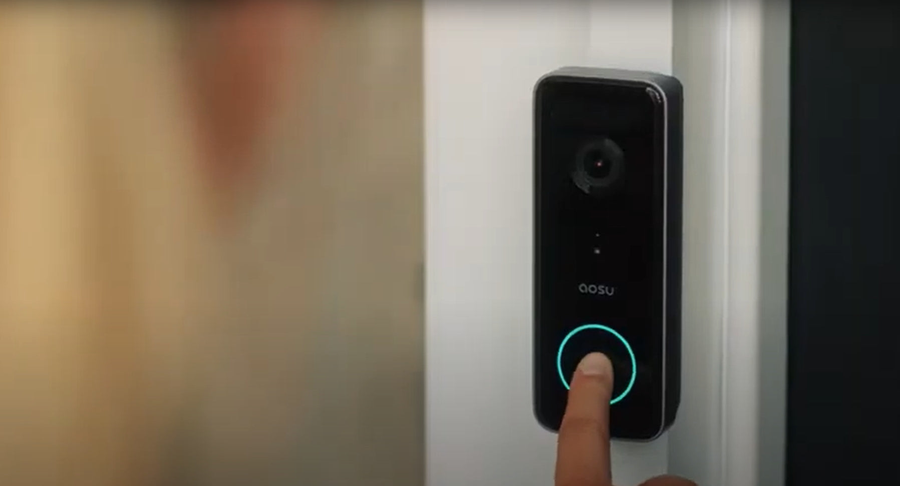

The aosu Video Doorbell Pro offers smart security without the hassle of subscriptions or complex setups. Designed for modern homes, it combines convenience, performance, and compatibility in one sleek device.
Key Features:
  • No Monthly Fees – Enjoy full access to features with no recurring charges.
  • Wireless & Battery-Powered – Easy installation with no hardwiring needed.
  • Smart Assistant Compatible – Works with Alexa and Google Assistant for voice control and real-time alerts.
  • High-Definition Video – Crisp, clear video so you never miss a visitor.
  • Instant Notifications – Get alerts on your phone when motion is detected or someone rings the bell.
Video Doorbell SE
The aosu Video Doorbell SE delivers a full view of your doorstep and smart features that keep your home secure—without any subscription fees.
Key Features:
  • Head-to-Toe View – With a 170° ultra-wide angle and a 9:16 vertical aspect ratio, you get a complete view of your front door—from visitors to packages on the ground.
  • Package Detection with Instant Alerts – Built-in smart detection automatically recognizes packages and notifies you the moment they arrive, helping keep your deliveries safe.
  • Two-Way Audio – Talk to visitors in real time from anywhere using the built-in microphone and speaker, giving you full control and convenience.
  • No Subscription Needed – Enjoy advanced security features with zero monthly fees.
