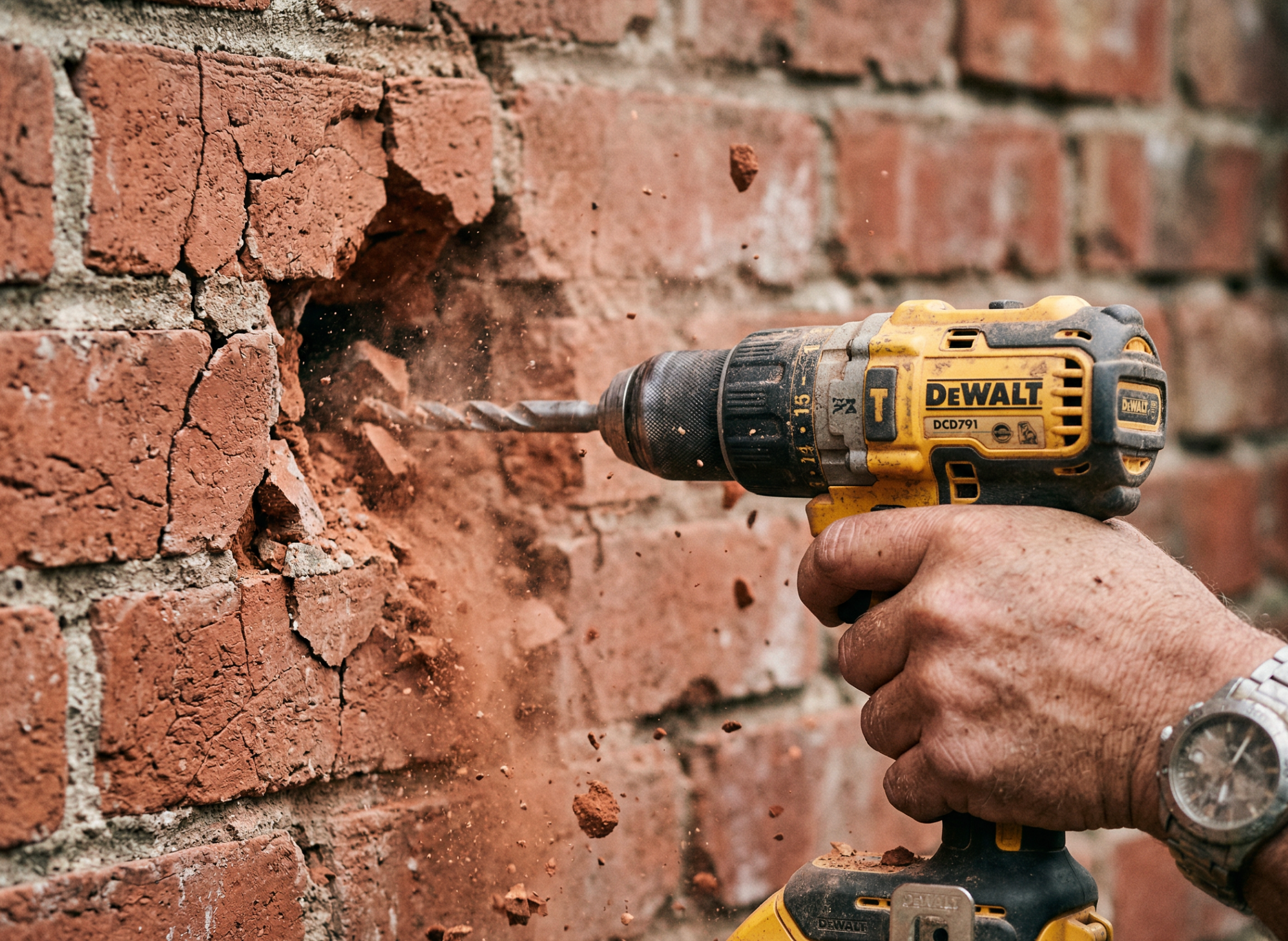

Step 3 — Drill Into the Brick
Use a masonry drill bit and drill slowly into the brick at your marked points.
Key tips:
  • Drill into the brick, not the mortar
  • Keep a steady pressure while drilling
  • Drill to the depth of your wall anchors
Why avoid mortar?
Mortar is softer and easier to drill, but it’s also crumblier and mounts are more likely to loosen over time.
Drilling into brick gives you a much more secure installation.

  • Drilling into mortar instead of brick
This is one of the most common issues and leads to unstable mounting.
  • Skipping anchors
Screws alone won’t hold securely in brick. Anchors are essential.
  • Using the wrong drill bit
o Regular drill bits are designed for wood and can wear out quickly or create uneven holes. Use masonry bits.
