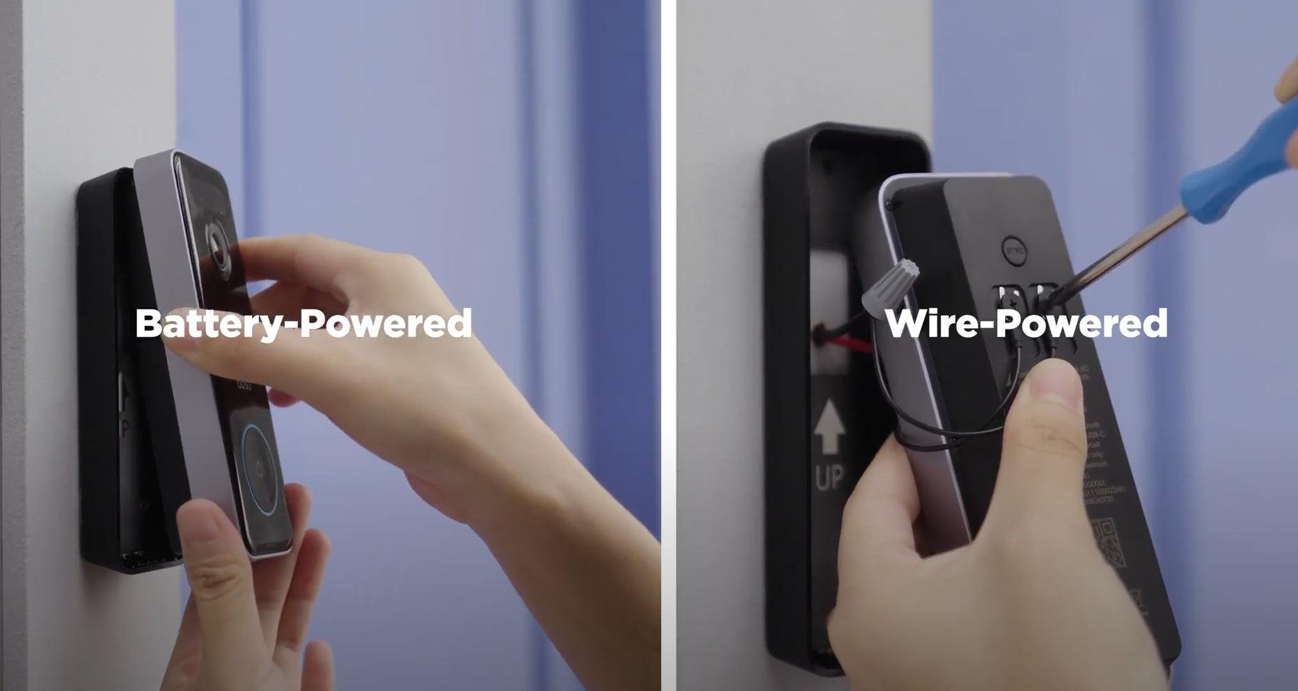

How to Install Your aosu Video Doorbell: A Step-by-Step Guide
Installing your video doorbell is a straightforward process that can significantly enhance your home security. Whether you have a battery-powered or wired model, following these steps will ensure a smooth installation. Here’s a detailed guide to help you get started.
For Battery-Powered Video Doorbells
First, find the best position to install your device. Choose a location at chest height to ensure an optimal field of view, capturing both tall and short visitors as well as packages left on the ground. Make sure the spot you choose has a strong Wi-Fi signal to maintain a stable connection. Poor connectivity can lead to delays or missed notifications, undermining the security benefits.
Next, use the provided screw hole positioning card to mark where you need to drill. This sticky card ensures accurate placement of the holes, making the installation process smoother and more precise. Proper alignment at this stage will save you time and effort later.
After marking the spots, follow these steps:
  1. Drill the Wall: Drill holes in the wall at the marked positions. If you’re drilling into brick or concrete, you may need a masonry bit.
  2. Insert Wall Anchors: Once the holes are drilled, insert the wall anchors that come with the kit. These anchors are essential as they provide a solid grip for the screws, preventing the bracket from coming loose over time.
  3. Attach the Bracket: Position the bracket correctly and use the screws from the screw pack to attach it securely. Make sure the bracket is level and firmly attached, as this will ensure that your video doorbell is stable and positioned correctly.
Finally, snap the video doorbell onto the mounting bracket. This should be a straightforward process if the bracket is installed correctly. When the battery is low, detach the doorbell using the detaching pin included in your kit. Recharging is simple: use the provided USB-C charging cable, which allows for quick and efficient charging.
For Wired Video Doorbells
Safety is paramount when dealing with electrical components. Begin by shutting off the power to your existing doorbell at the breaker box. This step is crucial to prevent any electrical accidents during installation.
Next, remove the old doorbell by detaching it from the wall and disconnecting its wires. Handle the wires carefully to avoid any short circuits. These wires will be used to power the new video doorbell. Connect the wires to the terminals on the back of the video doorbell, following the manufacturer's instructions. Typically, this involves connecting the live wire to one terminal and the neutral wire to the other.
After connecting the wires, proceed with the same steps as those for the battery-powered installation:
  1. Mark the Holes: Use the screw hole positioning card to mark the holes, ensuring they are correctly aligned.
  2. Drill the Wall: Drill the wall at the marked positions and insert the wall anchors to secure the mounting bracket.
  3. Attach the Bracket: Attach the bracket with screws, ensuring it is secure and level. A firmly attached bracket is essential for the proper functioning of the doorbell.
  4. Mount the Doorbell: Snap the video doorbell onto the mounting bracket. Make sure it is securely attached to avoid any potential falls or damage.
By following these detailed steps, you'll have your video doorbell installed and ready to enhance your home security in no time. Remember, the key to a successful installation is careful preparation and attention to detail. If you encounter any issues, refer back to the manufacturer’s instructions or seek professional assistance.
