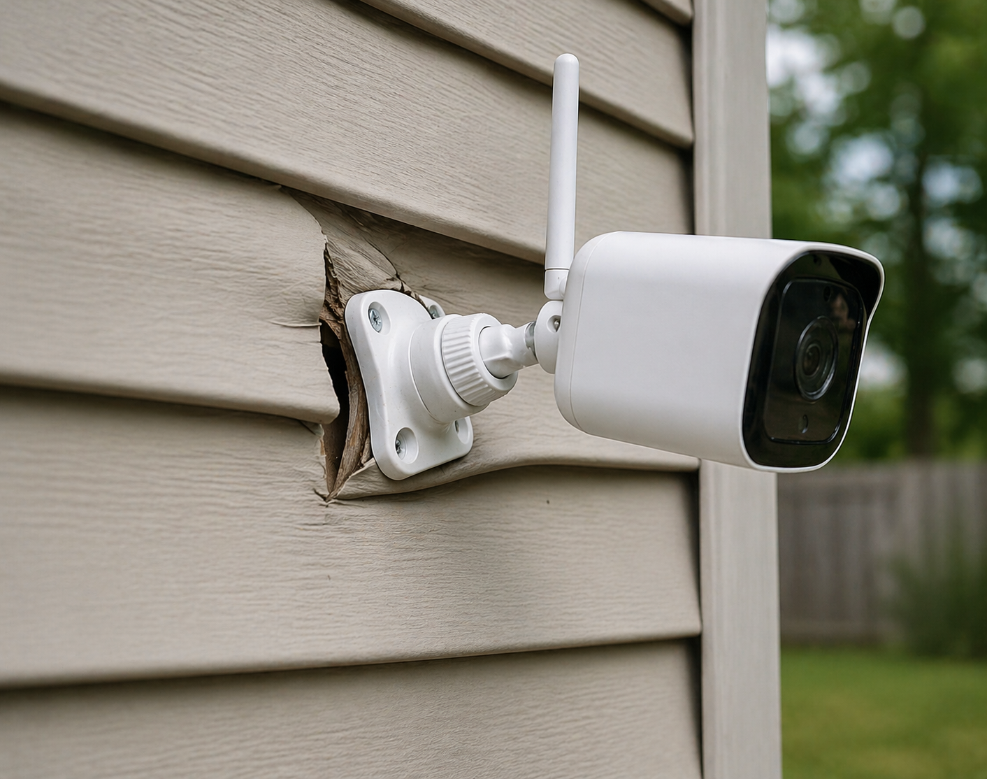

Common Mistakes to Avoid:
Drilling into siding only
Vinyl siding is not made to support weight on its own.
This leads to loose mounts, cracking, and long-term failure. It also exposes your home to additional water damage risk.
Skipping sealant
Even small holes can allow water behind the siding, which can cause mold, wood rot, and insulation damage.
Overtightening screws
Vinyl is made for slight movement.
If you overtighten or don’t leave additional space for flexible sealant in the vinyl entry points, siding can warp and panels can buckle over time.
Mounting in unsupported areas
Make sure you are drilling into something solid like studs or sheathing, not just insulation or empty space behind siding.
