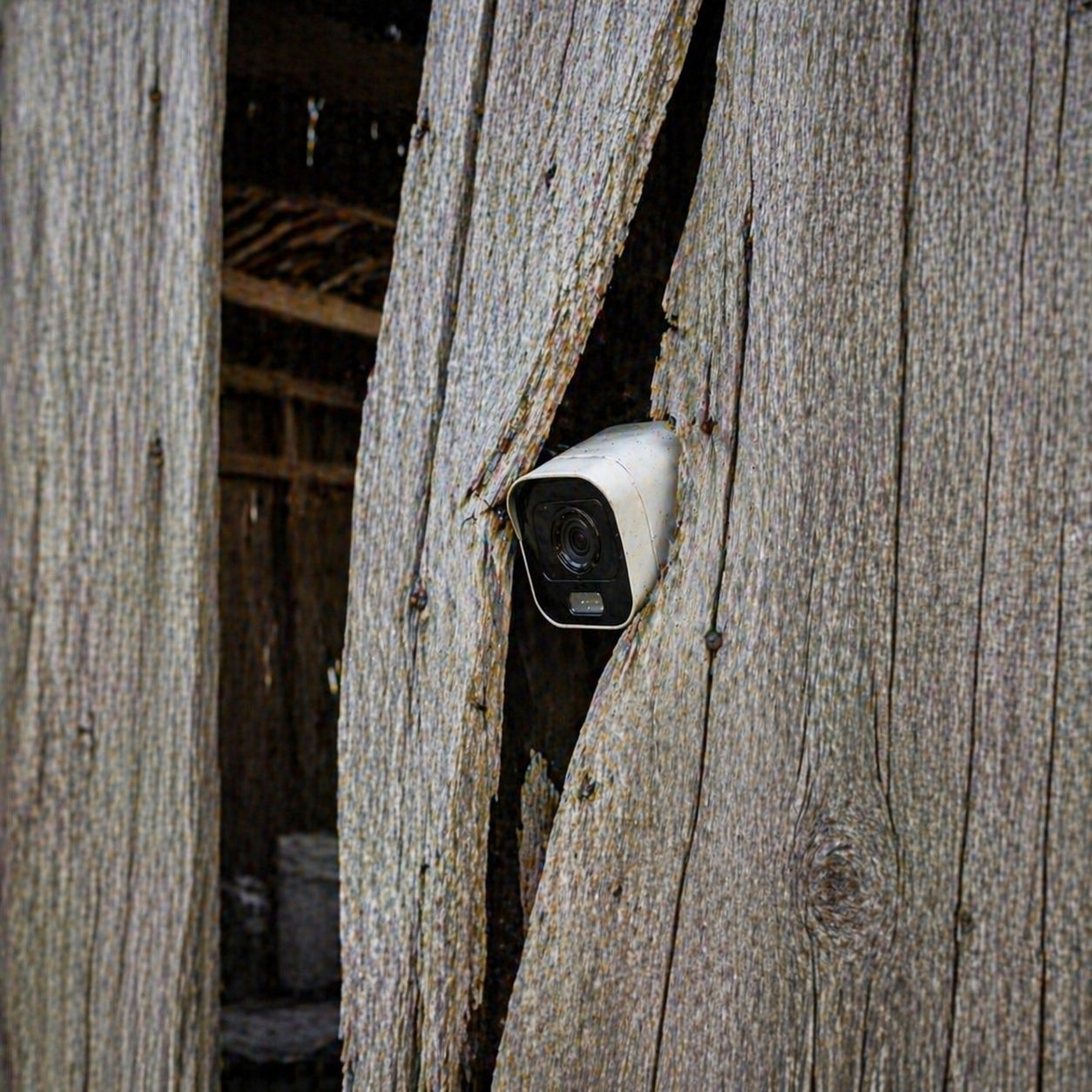

Step 2: Check the Wood Surface
Not all wood surfaces are the same. You may be mounting into:
  • Solid wood siding
  • Wood trim or fascia
  • Plywood or sheathing
  • A post, beam, or framing member
Solid, thick wood is ideal because it gives screws a better hold. Thin or damaged wood may not provide enough support, especially if the wood is thinner than the screws used for the mount.
